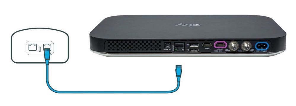

Use ethernet on your main box
Connecting your main Sky Q box to your eero device via an ethernet cable will ensure a stable connection for all Sky Q devices. If the eero is too far away for the supplied Ethernet cable to reach, you could buy a longer Cat-5e or Cat-6 Ethernet cable to cover the required distance (check out 'Replacing the Ethernet cable' in our article Using eero's advanced features to find out more). Whilst we appreciate this may not be the most convenient, it's proven to be the most effective solution to this issue.
Connecting your main Sky Q box to your eero routerConnecting your main Sky Q box to your eero router
