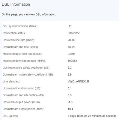

Just a general query to satisfy my curiosity...
My TalkTalk WiFi Hub black reports the following maximum line rate stats...
Maximum upstream rate (kbit/s): 24391
Maximum downstream rate (kbit/s):102852
My achieved line rates are...
Upstream line rate (kbit/s): 20000
Downstream line rate (kbit/s): 73926
I appreciate that the upstream rate is capped at 20Mb so no problems there, but am I wrong to expect the downstream rate to be closer to the 80Mb cap?
No stability issues or anything like that, just purely my curiosity.
Detailed stats are...
Would be great to hear feedback.
