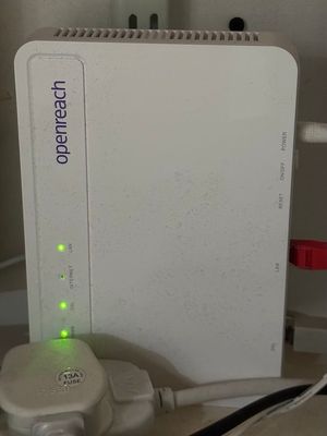

I have Fibre250 with the MT992 G.fast modem and a separate router.
Over the last months, the modem loses the internet connection intermittently (internet LED is off, see photo). It will usually resync with the network after a few minutes, but in the mean time there will be no internet. It's very disruptive, particularly for active zoom/teams calls. It can happen several times a day, or not at all.
modem
I registered a fault with TT and went thru multiple line tests. One of them indicated an issue and an Openreach engineer attended the cabinet (but not my house). They said it was solved but it isn't. I suspect it's not an issue in the cabinet and a good start would be to replace the modem.

The support team here will be back tomorrow and will hopefully be able to reply then to help further. TalkTalk can't supply a new Openreach modem (they can only supply their own TalkTalk routers), so if a new Openreach modem was required they would need to arrange an Openreach engineer visit for you.
The support team here may be able to run some more tests first to see if they can identify any other problems, they would then be able to arrange an Openreach engineer visit if they thought that was necessary.
