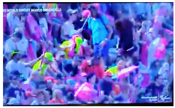

No it usually drops to low resolution which looks like this.
Sometimes it stops completely and I have to start the video again.

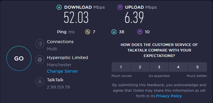

It seems like classic contention in that some speed tests slow right down in the evenings and particularly at weekends but it must be not local to me as other tests continue to be fast. It must be somewhere higher up in the connection to the wider internet. With the speedtest.net test I can specify different servers. I live in Greater Manchester so this is what it looks like to a local server last evening.
And this is what it looks like to the same server this morning.
So it is 21 times faster in the morning than the evening. It seems to me that there is a bottleneck somewhere in TalkTalk's infrastructure but not local to my line.
It would be interesting if other Talktalk users could try speedtest.net or which's speedtest and see if they get similar results.
