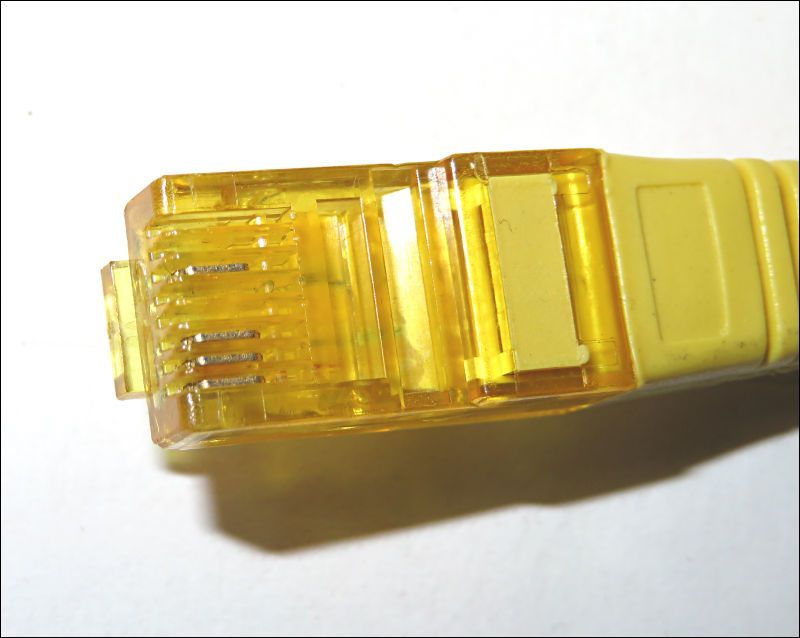

Just a quick note. Some cables provided with 3rd party equipment may not have all the twisted pair wires included in the ethernet cable - probably to reduce manufacturing costs, so it's always worth examining the connectors to make sure all the wires are in place. For instance, the pic below is from a cable I have, but I can't remember what it came with. It's always worth checking.
