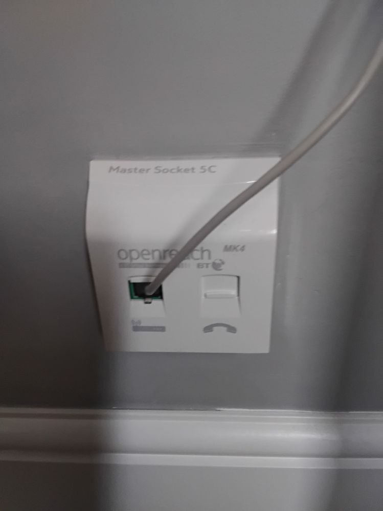

on 17-09-2025 10:50 AM
Picture as requested
on 17-09-2025 10:43 AM
Not yet received maybe it still loading that side.
on 17-09-2025 10:41 AM
I have sent a picture. But not sure if successful.
on 17-09-2025 10:11 AM
Please send a picture of your master socket.
on 17-09-2025 10:09 AM
The Openreach 5C does not require a microfilter it is built into the socket.
