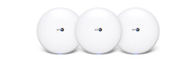

We wouldn’t normally recommend BT products but from the big discounts available now, they’re quite good value and work well although they have the fewest features.
BT Whole Home Wi-Fi is available in two disc and three disc versions for £149 and £189. Each disc is about the size of a side plate and sits on a chunky metal stand that you can’t move or remove.  Setting up is quite straightforward – the first disc connects with a LAN cable to the router and an LED on the bottom shows the connection status – purple when turning on, blue for a good connection, red for no connection and orange means you have a connection but you should move the disc closer to one of the other discs.
Like all Wi-Fi mesh systems, the BT Whole Home Wi-Fi creates a new Wi-Fi network that’s separate from the one created by your router.  If you stick with the default Wi-Fi name and password for the BT Whole Home Wi-Fi, you’ll find convenient pull-out cards on the back of each disc as a helpful reminder, although you can change the network name and password if you want.
Each BT Whole Home Wi-Fi disc has one LAN port and you can use this to connect to a YouView box although we recommend powerline adapters for the most reliable connection.  Out of the box, the BT Whole Home Wi-Fi is configured in Access Point Mode [see below] and the only extra feature is the ability to pause the entire Wi-Fi network which isn’t as useful as the individual device control of other Wi-Fi mesh systems we looked at.
Techy notes
BT Whole Home Wi-Fi is a dual radio system with an advanced 4x4 antennae configuration, giving it an AC2600 classification.  1 x LAN port per disc.
What we liked:
Easy to set up. Low cost. Good performance.
What we didn’t like:
Fewest features – only the ability to pause all Wi-Fi connected devices.
