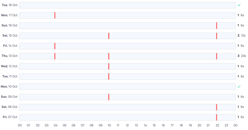

Interestingly,  looking at the disconnections history from my SamKnows box,  on Fibre 35 the drop outs would be for 6 seconds at three set times a day:
Since upgrading to Fibre 65 on 19th Oct,  the drop outs have become longer and are now at random times:

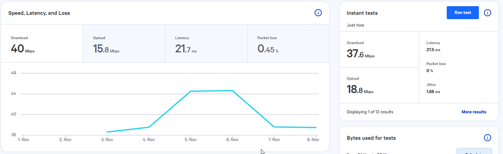

So just the download speed is "broken" then.
Skynet_TX
Message 53 of 65
The maximum possible upload speed for Fibre 35 is 10mbps, so as your image shows you are getting 15.8 'up' then this proves that your connection is still on the Fibre 65 contract.
Message 54 of 65
The speed I'm getting is the same as I was getting with my previous Fibre 35 contract.
Is it possible that my Fibre 65 has been reset to Fibre 35?

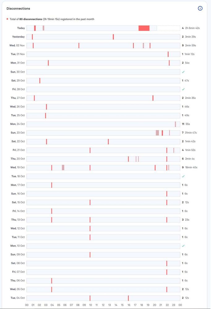

I'm not sure if it helps,  but here is the SamKnows disconnection history for October.
There were few short disconnects before the switch to Fibre 65 on 19th Oct.
