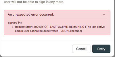

@Thunderbird2
Okay, so that' saying you cannot deactivate the account, because then there would no longer be an email account that is an admin user (which is required in order to access Mailbox Manager).
You can workaround that issue by adding a new mailbox with admin user rights.
With an additional mailbox that has admin user rights,  you should be able to go ahead with deactivating the email account that has the login issue, and then reactivating it again.
After doing that, you could delete the additional mailbox if you so wish.

I've already tried that with no success. I've just tried 'nameunknown' suggestion,(thanks) and actually managed to get to my mailbox by trying another browser, problem is when I tried deactivating the account I get this message.
Please re-instate my account.
Thanks.
