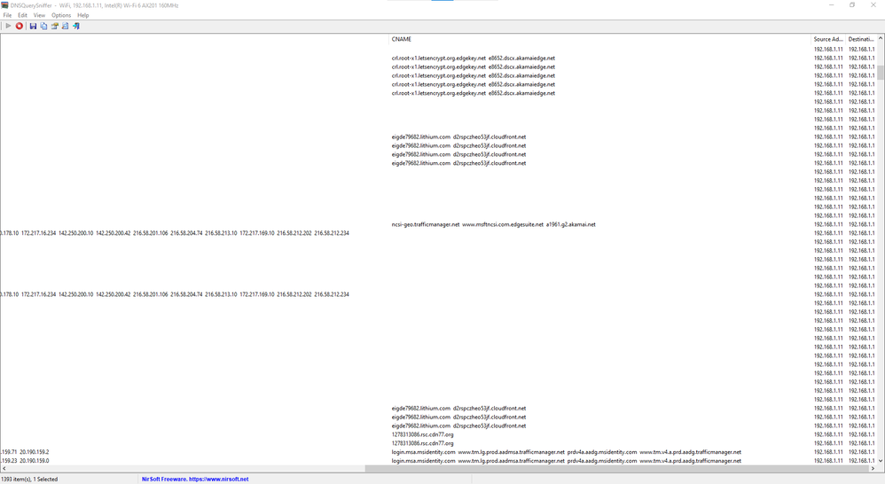

Message 19 of 45
@KeithFrench
Not a problem, Keith
Here's 2 screenshots. The first is the screenshot of the left side of the DNSQuerySniffer window. The second is the screenshot of the right side of the DNSQuerySniffer window. Obvious its not the whole list, just a part of the vertical window.
LeftLeft
RightRight
It seems DNSQuerySniffer is working normally now.
Bill
KeithFrench
Message 20 of 45
It is very difficult to respond to your questions when you talk about something that you have seen in this app, but will not share a screenshot of it.
Keith
