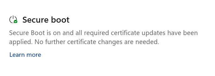

Hey Keith after a bit of tinkering and some messing with dell drivers i have arrived at this (see pic), the firmware protection is still greyed out/admin rights but i am giving up on that, its just too much hassle.
ps dell drivers are probably the most hit and miss i have used, lenovo are much better from my own experience
rgds
edward

Hi @loxocemus
Another thought. Is your motherboard running the latest, non beta, UEFI update (BIOS Update). If not, do later releases mention anything about this problem? As far as actually doing a BIOS update, I have no idea of your skill levels, so you do that totally at your own risk.
yesterday
Hi @loxocemus
Sorrry but this is getting totally beyond a TalkTalk issue.
From what I have read, getting True from that PowerShell cmdlet, you should be good to go, but there is more to it. Your image is showing that you are using an older boot trust configuration that needs to be updated. I am no expert on this, but I have spent some time trying to find out for you. This MS site:-
Says:-
A green icon means that your device is sufficiently protected and there aren’t any recommended actions.
If this is a laptop or a pre-built, I would consult the support team of the manufacturer/system builder from whom you got it. If you built it yourself, I would go to the motherboard manufacturer's support team for guidance.

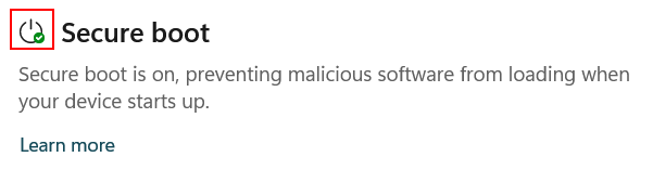

hey keith, i have this, see pic, which i assume means i haven't got the latest rollout from win update yet, but i get this from powershell saying i do have the latest certificates ?
"S C:\WINDOWS\system32> ([System.Text.Encoding]::ASCII.GetString((Get-SecureBootUEFI db).bytes) -match 'Windows UEFI CA 2023')
True"
rgds edward

No, that's not what I had it sounds like the update has not been applied. In Windows Updates History, under other, do you have this update:-
Secure Boot Allowed Key Exchange Key (KEK) Update
Now go into Windows Security > Device Security
In the Secure Boot section, there should be a small green tick on the power button icon:-
Secure Boot
Wednesday
