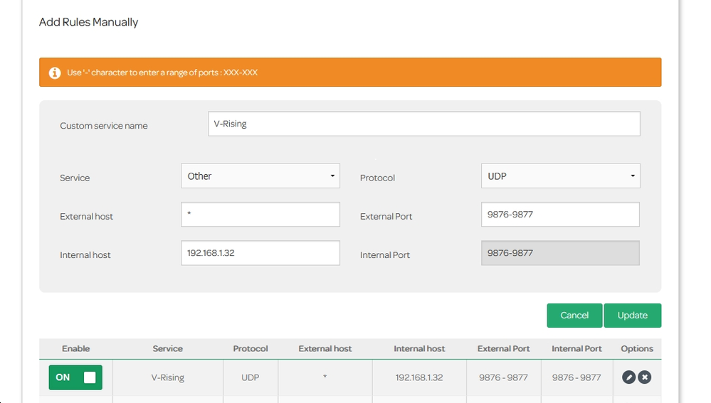

You have either the Sagemcom F@ST 5364 or 5464, you can tell by pulling out the pull-up panel at the back and it is quoted on the label behind that.
There is something wrong with your attached png, it will not open.
The first and most obvious problem though is that port-checking websites are only compatible with TCP ports, not UDP ones. This means that they will always report closed. I do have my own way of testing them though.

UDP 9876-9877 and my PC with the game server on has the IP that i have reserved 192.168.1.32
Ill add the screenshot 🙂
I very much appreciate you taking the time to help 🙂
