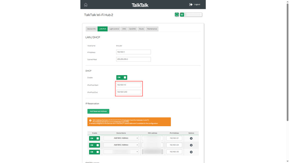

I have just tried this on a 5464 (Hub 2) which runs the same firmware. I first restricted the DHCP scope to end in .249 and clicked Apply. Then I added three DHCP Reserved IP addresses without any problems:-
Scope ends with .249 & 3 res addrScope ends with .249 & 3 res addr
I'll wait to see your video.

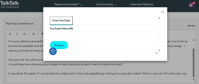

Other than that, I need to see screenshots as a long description is very difficult to follow.
I'm sorry about overloading you. My pet peeve from answering forum queries for over 20 years was lack of information, so I try to be as precise as possible and therefore when I'm doing my questions I do my actions and write them out with the results of every stage.  I also try to think of every permutation of action, as often this will help.
Can you tell me what screenshots you would like to see and I'll add them.
I could take tens showing each stage of each process, so don't want to flood the feed.
It would be far easier if I could attach a video, but is this only possible by linking to a youtube video? Which I can do if it's the only way. This is my only option when clicking on the video button above this post. I cannot select anything other than Youtube, I have tried.

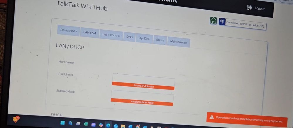

I didn't leave them blank.
When I log in and navigate to the page the fields are populated.
When adding multiple reserved items and it fails to save this is the sequence of events.
I press save
Press yes
It circles for between 20 seconds and a few minutes.
The page I screenshot pops up for about half a second and then disappears and I return back to the log in page.
The router is unpopulating them itself.

I've attached a picture I took of the window showing the failure messages.
Graham
