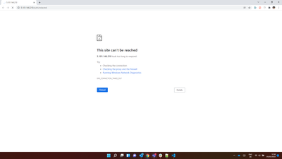

Message 32 of 50
Hi @Anonymous,
sure, here you go.
PS: I don't have a Proxy nor Firewall in my laptop blocking this request. It works fine when I am connected to a different ISP.

Message 33 of 50
Hello,
Would it be possible to provide a screenshot of the specific message that you see when you can't access this site? (Please do not post any personal information)
