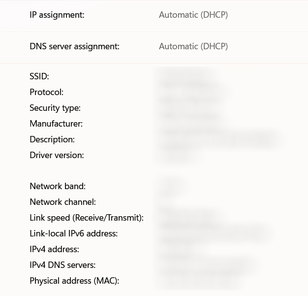

Within Windows (assuming Windows 11, but Windows 10 is very similar) please go to:-
Settings > Network & Internet > WiFi
Then get a screenshot of this section of the display:-
WiFi SettingsWiFi Settings
Whilst I have blurred my data, please do not do this on yours, otherwise it will be of no use to me. I would suggest that you PM me this screenshot to preserve your privacy, otherwise anyone will be able to see it.

That IP address is the router's one. If you have configured your WiFi adapter to use a static IP address  of 182.168.1.1, I am not in the slightest bit surprised that you are having this problem. You must never do that.
Please reconfigure it to use a dynamically assigned address via DHCP.

How is your WiFi card set up in respect of IP address allocation, is it dynamic via DHCP or do you have a static IP address configured on the WiFi adapter?
