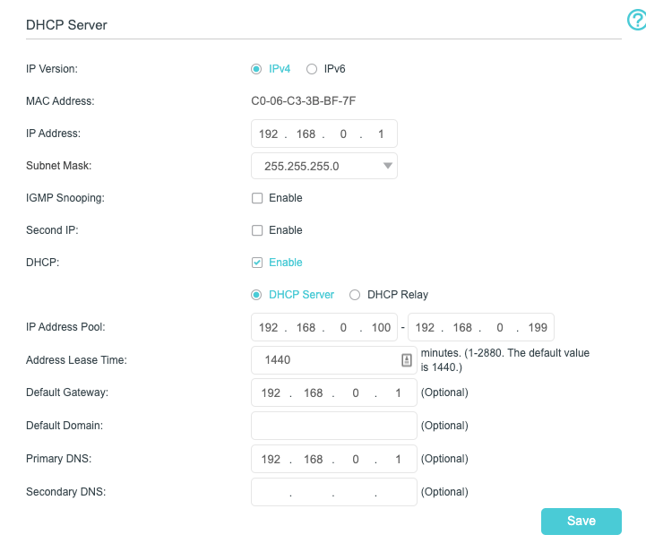

Attaching some screenshots with other settings.

on 03-08-2022 07:19 PM
I'm using the VR600, and the only obvious differences are the LAN IP address being 192.168.1.1 and the Default Gateway (under the Internet Connection Setup) being " ipoe_ptm_101_0_d ", not "Current connection" - are there other options in that drop down list ? As you might expect, the IP address, Subnet mask and Gateway are populated with the WAN addresses on mine.
