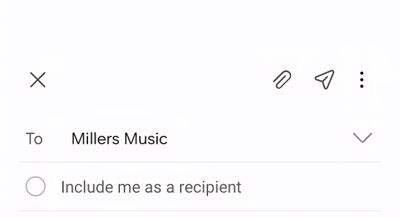

on 18-10-2025 09:12 AM
It may be that at some stage you've clicked on "include me as a recipient" which appears (mine is a Samsung app) above the From address, @Flumoxd ?
It would certainly make sense to actually use that for keeping duplicates of anything important- although they are obviously also to be found in the "sent" box.
In sent, in this app, the emails sent automatically disappear from view after a week or two [so not like in Gmail, for example] but are retrievable if searched for.
Automatically being sent a copy of what you have sent means that you will have it current in your INBOX with every reply for reference and could be useful for storing records when it comes to correspondence about contracts etc.
I've never clicked on it myself, but it's there for a reason and could be useful. It's probably just since the spring that I have started noticing the option too, so it's maybe a new "thing" with some email clients?
Easy to select it by mistake too as our screens are so touch sensitive...
Just some thoughts.😊
