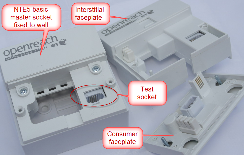

I'm asked to connect the router to the test socket but my phone point is a BT MK3 box where the line to the router is connected direct without the need for a microfilter. What do i do now?

Just undo the two screws in the lower half of the faceplate & gently pull that off as there could be wires attached to it:-
Consumer faceplate removedConsumer faceplate removed
Then pull off the interstitial faceplate to reveal the NTE5 assembly where the test socket is:-
Component partsComponent parts
