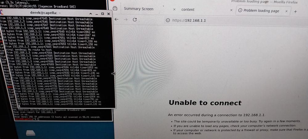

Yes, I left it overnight and it's still doing the same thing. I've got a Linux mini server wired to it running continuous pings and it shows it as responding intermittently. Apologies; I'm not familiar enough with Linux to take a proper screenshot.
