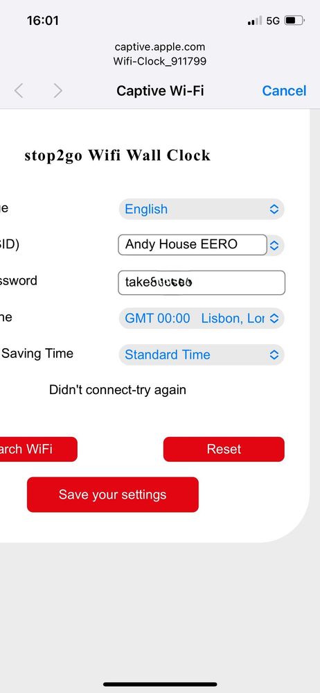

I have bought a Mondaine Stop2Go clock that needs to connect to Wi-Fi to be able to set the time and also keep it updated to the correct time. I am on TalkTalk Full Fibre 500 and I use a 3 X EERO mesh. The problem is that the clock will not connect to my Wi-Fi. I am hoping that someone might be able to help as to why my clock will not connect to my Wi-Fi.
I am using an Iphone 12 to make the clock/Wi-Fi connection
I bought the clock a couple of days ago and after fitting the batteries, followed the Mondaine connection instructions. The clock finds my Wi-Fi, I enter my password, save the settings, wait and then I get a message saying "didn't connect try again".
I took the clock to another house and tried it there. This house uses Vodafone broadband service (fibre to the cabinet), and has a seperate router and a 3 X Tenda Mesh system. The clock successfully contected to this Wi-Fi without any issues and set itself. This confirms that the clock functions OK and the problem is with my Wi-Fi.
I have tried to do this connection around 50 times now over 2 days and it seems clear that it is not going to connect.
The clock says it needs to communicate at 2.4ghz.
These are the fixes I have tried so far, without success:-
1) Talked to the clock supplier for help. The say "it should connect to your internet -- there is something wrong at my end"
2) Powered down and re powered up my 3 X EERO's
3) Entered the EERO app and went to troubleshooting -- turned off 5G for the allowed 10 minutes
4) Entered the EERO app and went to troubleshooting and turned ON legacy mode (non Wi-Fi 6)
5) Took out 2 X EERO's and tried to connect using only 1 X EERO
6) EERO app software update to latest one (yesterday)
7) Tried doing the Wi-Fi connection using an alternative iPhone
Below is a picture showing the clock setup page on my iphone with the error.
App errorApp error
