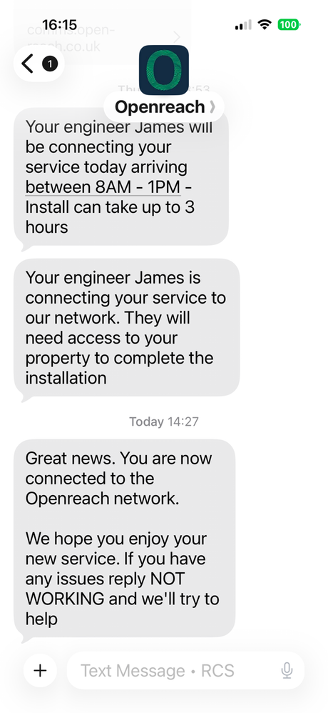

Hi Phililie
I have received this via text.  Does that mean its ok to try the new router now ?
Message 124 of 134
As per the note the next review will be on the 8th this is when we will get the next update once all is done your account will also be updated.

For staff to run tests, @MerseyRayUK, the new router will need to be plugged in.
Can you let them know when you will be able to do that?
