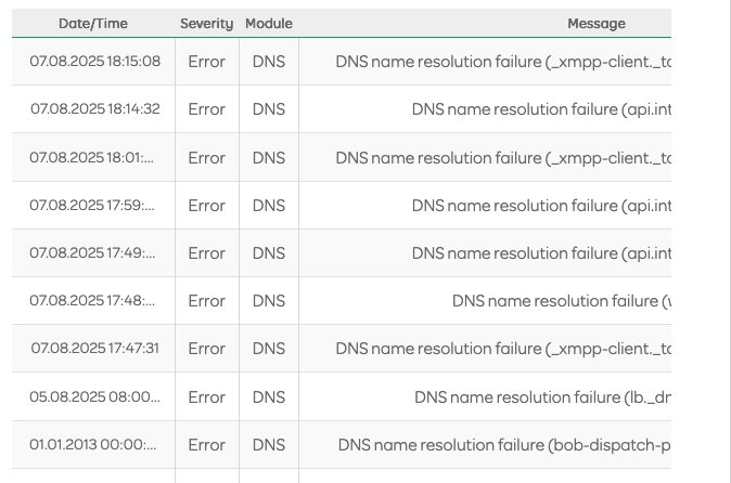

So I have gone to the logs in the router to see if that helps and I see the following (See pics)
It looks like somebody has been having problems with this router in 2013. Im guessing its then been sent back to talktalk for a replacement and they have sent me this faulty router.
The only way to get the internet working on my devices again is to restart the router, it works for around 2-3 hours and then the same error happens.. All devices yet again dont work, and the router light is still lit and says connected in the router admin panel.
The majority of the errors are pointing to the DNS resolution failing.  I checked in the DNS settings and somebody had entered 192.168.1.1 as the DNS server, which is the router IP so wouldnt achieve anything..  I have removed that IP and the error is still there.  This leads me to believe that the last person was experiencing the same issue that I am now getting.
Screenshot 2025-08-04 at 21-09-11 TalkTalk.pngScreenshot 2025-08-04 at 21-23-08 TalkTalk.png

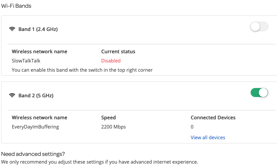

If you have disabled any WiFi bands on the Sagemcom WiFi Hub, then due to a bug it will require a factory reset to bring it back to being as it should, despite what the UI will show. All of the DNS entries in the logs can be ignored, that is down to a bug in their classification as Error. I reported both of these bugs a while ago.

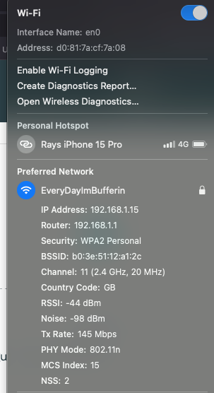

From what I can see, the problem is that your MacBook won't connect to the 5GHz band, is that correct?
Please factory reset your router so as I can try and see why you can't. Slow speed, intermittent dropouts, breaks in the signal or no signal on some or all devices or no internet access might be caused by Wi-Fi interference from other local networks, which can also lead to a permanent reduction in speed. No ISP can be responsible for your local environment; this is mainly a byproduct of the popularity of Wi-Fi.

And the wifi on my macbook now shows 2.4Ghz... Im currently sat around 3 metres from the router

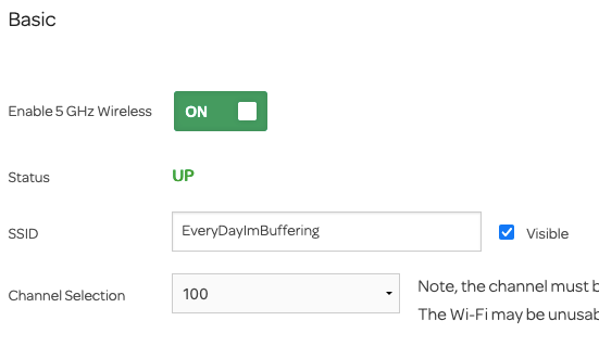

And I have selected channel 100 but the router is ignoring that.  Channel 11 is not a valid 5Ghz channel.

Now all devices it seems are connected using 2.4Ghz, even though I have disabled that.
And the router doesnt show any wireless devices connected to it, so theres definately a fault there now after what he did.

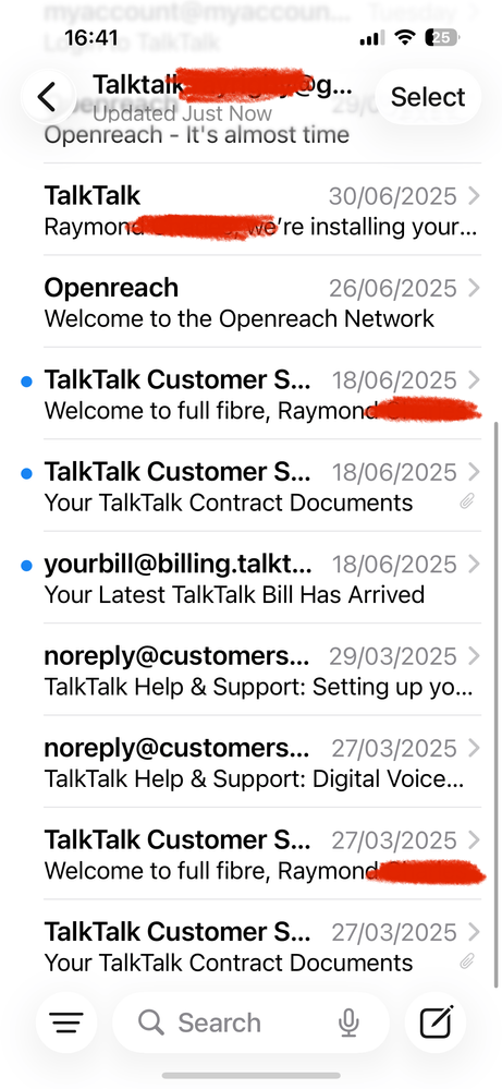

Look how long this has been going on for..
I got my contract documents for this full fibre 27/03/2025

I have now put the new router on and already getting the same errors. (see pic)
The old router was connected to the full fibre service since tuesday and stayed connected at all times, and no errors in the log.
Ill update again if the service disconnected in the next couple of hours.
