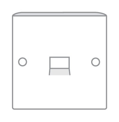

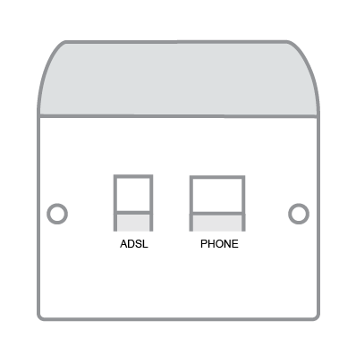

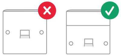

Plug your router into your master socket.
Use your microfilters correctly if you have a standard master socket:
Use your splitter correctly:

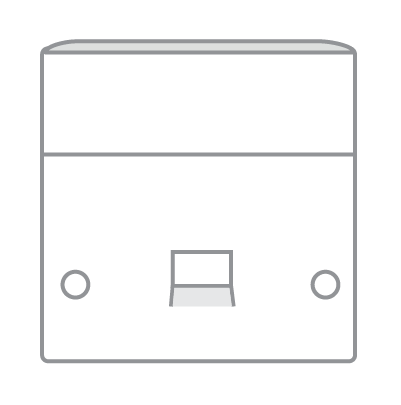

If your master socket has a horizontal line across the middle it has a test socket. Connect your router to the test socket to check for problems with your external wiring:
Has your speed improved?
There could be a fault with your internal wiring. This isn't something we can fix online; please contact us so we can help you.
Is your speed slower or the same?
There could be a fault with the wiring outside your home. Please contact us so we can look into it and send an engineer if necessary.
