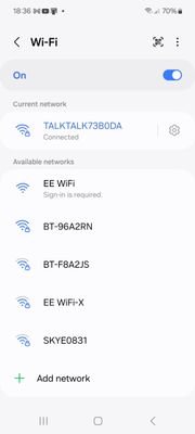

My router has stopped broadcasting the band 1 (2Ghz network). Band 2 (5Ghz network) is fine, but band 1 just isn't there any more. See the attached phone screenshot as evidence. I've been on chat with tech support for 2h 45m and I'm getting nowhere. Please help, someone! I think the router is malfunctioning. The tech support guy is trying very hard, but he just doesn't understand what the problem is.No TalkTalk73B0DAband1 networkNo TalkTalk73B0DAband1 network

Did that when I set them up three months ago, that was the only way to differentiate between the two bands.  But wait a minute...
*goes away to check something*
Well blow me down, here's the update. I had renamed the two bands (a few months ago) as you suggested. But what I hadn't done is checked that the bands were still (re)named as I renamed them. They weren't. Band 1 had defaulted back to the old name and I couldn't see it on a scan because it was overlaid with the Band 2 name (both names being the same).
What I've just done is change Band 1 back to the name I gave it a few months ago and Robert's your Mother's Brother, everything works once more!
I have no idea how or why the network name got changed, I hadn't even been in to the portal since early December.
But if it hadn't have been for you, I wouldn't have thought to go back and check that the Band names were unchanged. Thank you for putting that idea into my head.

Thanks for your reply. Yes I've logged in. Yes the router says 2Ghz is broadcasting (see my screenshot for the truth - it really isn't). Yes I have devices that need the 2Ghz network, otherwise I wouldn't really bother with it.
