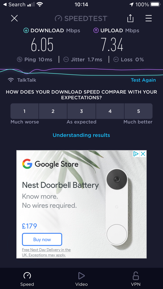

on 24-02-2022 10:42 AM
Well this is getting even worse. Did some speed tests again this morning. The one showing 25Mbps is after rebooting the router. These are all wired connections, apart from two from my iPhone to show it's not my laptop giving the problems
