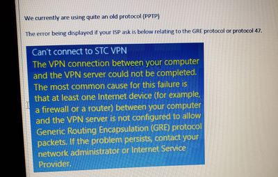

on 24-03-2022 08:09 AM
Hi I an using SG4K100136. The email it department are saying it is a firewall issue the router is blocking the connection please see below photo thank you
on 24-03-2022 06:47 AM
Hi hogyebear
I'm sorry to hear this.
I will speak to our Products Team about this. Which VPN client are you using?
Debbie
