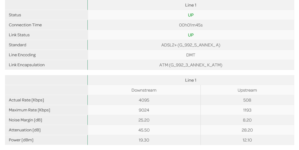

I have removed a number of devices from the phone system and am getting fewer crackles during calls.  This may be reflected in the improved SNR  - see modem report.
latest reportlatest report
Maybe there was an issue there HOWEVER after rebooting the modem I am still getting pathetically low actual speeds - less than half of the maximum speed the connection allows.  Is there any way to get the modem to give a better performance?  The 4.1 Mbps/0.5Mbps is most frustrating?

Yes, I am at home - the connection speed has dropped even further after two disconnections:Screenshot 2025-07-15 at 12-53-43 TalkTalk.png
Am I being throttled?
