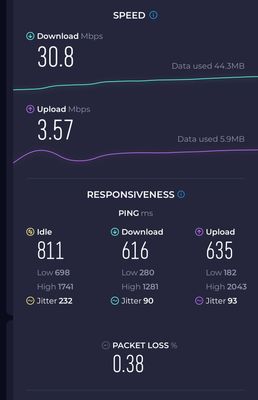

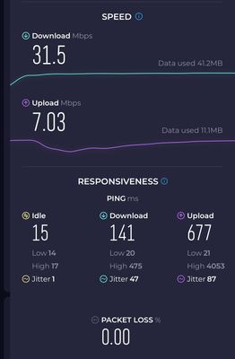

Seem to be getting some kind of interference on the Router (Wifi Hub).
Generally Fibre35 gives me a solid 12-17 Ping with 30Mbps down 6Mbps up.
However I keep getting intermittent drops to 500+ Ping with single figure Mbps down and less than one Mbps up. Particularly noticeable on XBox with online games dropping out or lagging badly.
Tried both Wifi and direct Ethernet connection between Xbox and Router and it seems to persist.
I may have narrowed it down to either or both of TV (older plasma) and/or Sky HD box but it's so intermittent its difficult to be certain.
It also happened a couple of years ago and a replacement router seemed to fix it until now, could it be this replacement router has developed a similar issue?
Grateful for any ideas!
