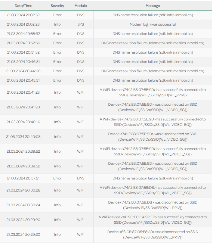

Here's the log for the preceding half hour, with filtering turned off.
Unfiltered router logUnfiltered router log
You can see me logging onto the router and everything else it has been doing for the previous half hour, while no-one was looking. I was watching TV on the YouView box.
In a further puzzle. Having extracted the above log, and reached the screen shown below. No amount of clicking on black or green "Home" symbols would return me to the router's home screen.
Router Wi-Fi display screenRouter Wi-Fi display screen
Just says "We are loading your dashboard" and comes back to same place. I notice that top right it says "Internet: Disconnected", which at that moment, it wasn't! That of course might be a reference to the fact that there is no VDSL line connected to it. I don't suppose many people feed this type of router from a modem via PLAs.
The Logout button worked just fine.
This mystery is not urgent to solve, isn't ruining my life, I've been living with it for months, and willing to continue to do so.

You can normally ignore all the DNS entries as the classification of them is wrong. They should be "Informational" not "Error". I am waiting for this to be fixed.
The router is, as you say, confirming internet access. Are there any non filtered stuff in the router's log that show anything to do with the wan going down or coming back up again? Perhaps it was all back up by the time you logged onto the router?
