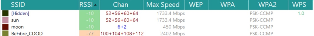

When setting up my network I originally named the two networks:  'sun' which is the 5Ghz, and 'moon' being 2.4GHz.
I have added some screenshots from Tarlogic's Acrylic Wi-Fi analyser. I also recently enabled the guest networks to see how they appeared on Acrylic.
You can clearly see this mysterious "hidden" network is originating from my talktalk router as the signal strengths are much higher than any neighbouring wi-fi networks (the five mac addresses are also very similar as expected) also they all disappear when the router is powered down.
Still confused what this hidden network is doing and have temporarily disabled 5GHz.
