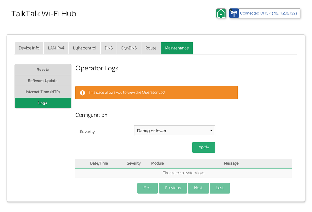

on 01-11-2023 07:12 AM
Morning,
Thanks for the update. The logs should be present. Could you try resetting the router and set this up again and let us know if the logs show please?
Michelle

I thank you sending me a new router, I have set it up and I will monitor the connection for sure.
However I cannot see any logs in new router's system, compare to my old router, even a login operation will lodge the log.
this would be a tricky things that even there is a dropouts happened I am not able to check it with the logs, unless I see it happen with my eyes....
So is there a setting to turn on logs? please advise.
no logs recorded.
