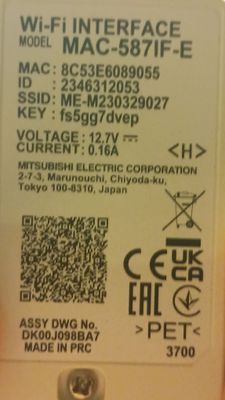

Hi @KeithFrench . This device is a WiFi interface to heat pump control system manufactured by Mitsubishi (details attached).
My router is located close to the cable entry on the ground floor. The device is one of two in the loft of a two-storey detached house, the other being a solar inverter. The loft insulation has a metal foil covering and the HP control system is encased in a steel box. The WiFi interface is external to the steel box and only 2 m away from a WiFi extender. The inverter's WiFi interface doesn't have this problem.
