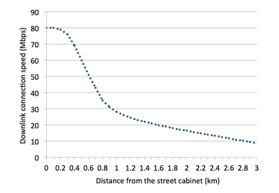

The 'VDSL' rows at the top of the results on that site should also have given you an estimate of the speed BT think your line could achieve, would be interesting to see if that is anything close to the speeds TalkTalk think your line can achieve.

@Bankendrob wrote:
I found the graph most interesting as we are probably around 2.5 miles from a fiber equipped cabinet and our speeds are nowhere like the ones shown. 10mbps, in your dreams, we are struggling to get 2mbps
@Bankendrob ,
The important factor is the length of copper wiring from your house to the cabinet. Bear in mind that this wiring may not take the most direct route to the cabinet and also that the cabinet physically closest to your house may not be the one you are connected to anyway.
have you done a search with your address here?: BT Broadband (btwholesale.com)
That should tell you which cabinet you are connected to (PCP cabinet number, which should have their numbers painted on them, and which will in turn be connected to a fibre cabinet located very close to it) and an estimated speed range for your line.

Hi Skynet,
Thanks for the advice, I have checked and definitely on fiber35. I found the graph most interesting as we are probably around 2.5 miles from a fiber equipped cabinet and our speeds are nowhere like the ones shown. 10mbps, in your dreams, we are struggling to get 2mbps which is why I think we have a line problem despite the clear test results from the talk talk end of things.

Hi @Bankendrob,
If you are now on Fibre 35 the distance to your exchange is irrelevant, it is the distance between your home and the street cabinet that your phone lines connects to that matters, this is because the connection from the street cabinet to the exchange is fibre optic, and so is super fast, it is only the old copper phone line between the street cabinet and your home that causes the drop in speed based on the length of the line.
If you have noticed no real change in speed since the upgrade, the first thing to do is to check to make sure the upgrade really has happened.
  1. If you log into 'My Account 'does it show you are on Fibre 35
  2. I'm not sure what model of router you have, but if you log into your router and go to the screen that shows your connection stats it will show the line standard, this will say ADSL if you are still on your old copper connection, and VDSL if you are on Fibre
If you don't know where to find that info in your router, then let me know what model of router you have, and I can try to advise where to find that info (if it is a router I'm familiar with).
If you are doing a speed test from a wireless device then this can affect the results, as your Wi-Fi environment could affect the speed, are you able to run a speed test from a device connect 'wired'. Also, when you check the stats in your router you should be able to see a 'downstream line rate' or 'downstream actual rate', this will be the speed that your router is actually connected at.
The staff here won't be around now until Monday, but they should be able to respond to this post early next week to help.
Approx. speed you could expect on FTTC Fibre :
