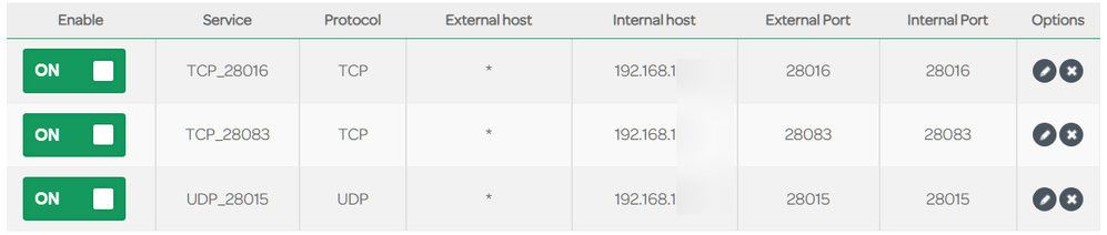

Thanks, no problems there. Can you try deleting the TCP one that does not work & then adding it again? How are you testing the UDP one? The only difference with mine is that I only ever set the protocol to TCP & UDP if it will use either, if not I always specify them exactly:-
My rulesMy rules
Keith
