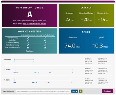

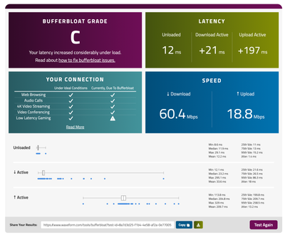

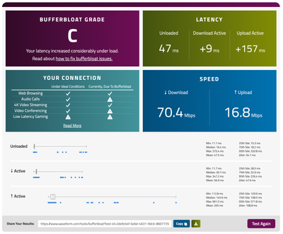

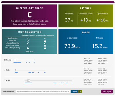

I have set it up, and while the downlink/uplink speeds seem generally fine, I’m experiencing significant latency issues, particularly on the uplink—even with a wired connection. I’ve outlined my findings in the brief study below.
TL;DR: There seems to be an issue with the VDSL modem on the Sagemcom router I received.
To try to pinpoint the issue with the new router from Sagemcom (SG) I compared it with my older TT one from Huawei (HW) across different scenarios: (1) wired connection (Laptop to LAN), (2) wireless connection (Wi-Fi 5GHz), and (3) a combined setting where the HW router acts as a “modem” with the SG router’s WAN connected to the LAN of the HW router.
Wired connection (LAN).
HW:
SG:
Wireless connection (WiFi 5GHz).
HW:
SG:
"Modem mode" HW -> SG ->
Wired:
Wireless:
I’m not sure if there’s an easy fix for this, but for now, I’ve decided to switch to a third-party router.
