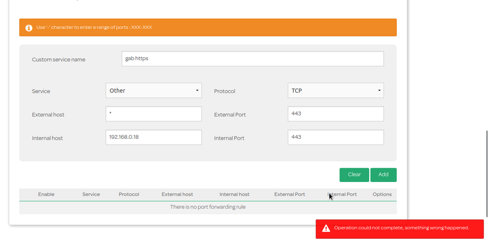

Adding the rule manually results in the same dreaded message, "Operation could not complete, something wrong happened."
Guess I will have to do a factory reset and see how that goes.

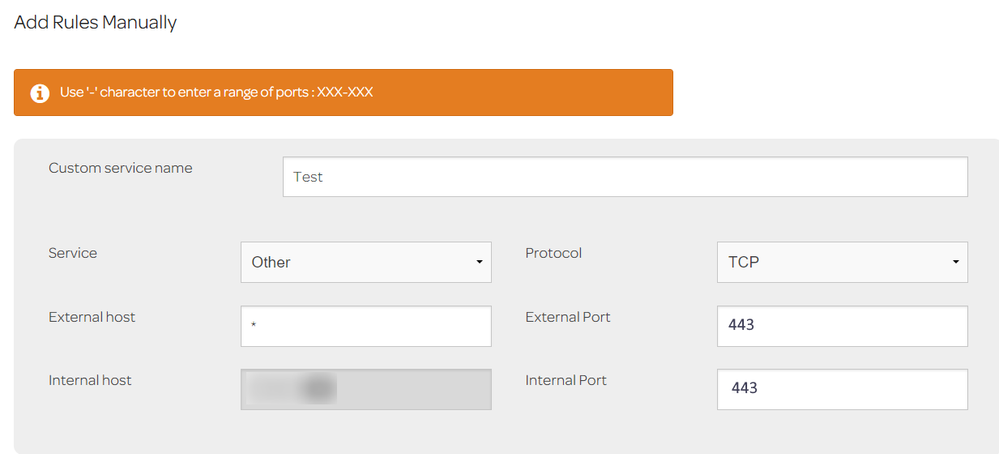

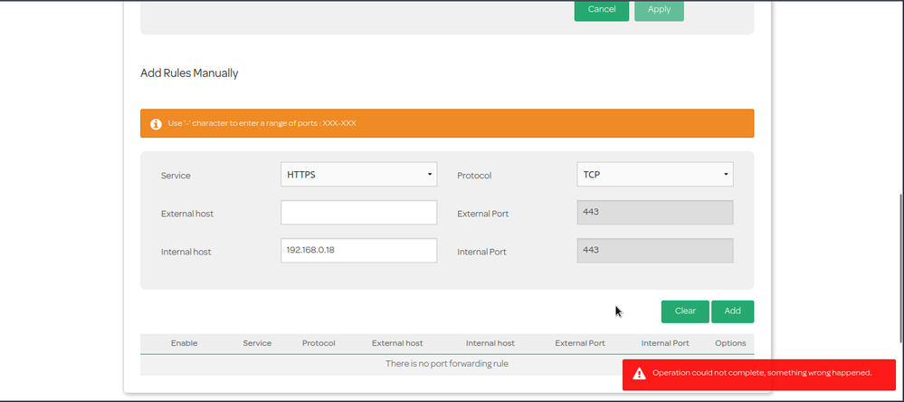

It's not that a forwarding rule it's not working, the issue is that I cannot add a forwarding rule.
Every time I try to add a forwarding rule, I get the message "Operation could not complete something wrong happened". Screenshot attached.

As a result, I am getting the same issue.
Not sure what to do - except a factory reset. This issue has been going on for the last 8-10 months, is not new.
