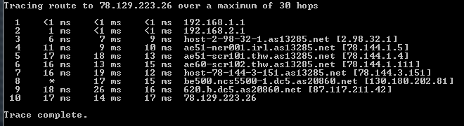

15-09-2022 09:28 PM - edited 15-09-2022 09:32 PM

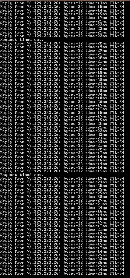

My Google alarm for 8 didn't work! At 9pm Which's download was only 1.7 Mbps.
Traceroute to Which.
Ping to Which.
Ping to Which
Ping to google.co.uk.
Google
Although the pings are slower than in the morning the times don't look too bad and neither does the traceroute. The only noticeable thing is the packet loss, which I don't get during the day.
Whatever Which's download is actually testing seems to perfectly match the data rate I get from Dorna's servers. I could not play HD resolution at this time but I could get 720p. When Which shows really slow download speeds, less than 1 Mbps sometimes, I get potato vision videos from Dorna.
