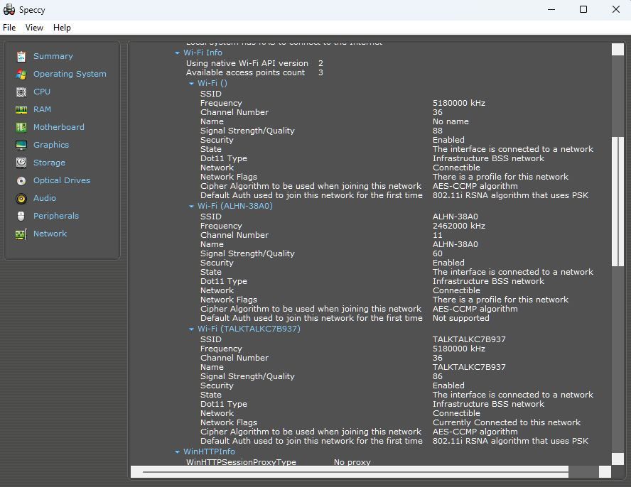

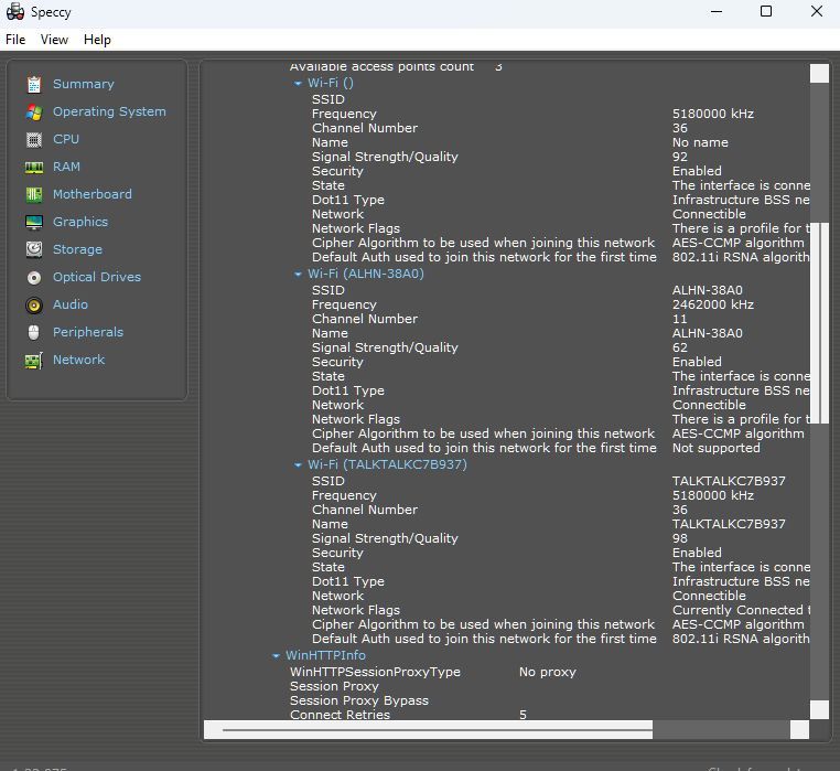

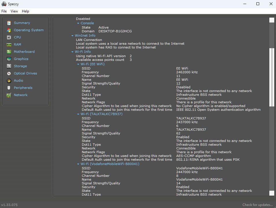

These are the results taken this morning.
Holding my phone against the router I get Down 106.2  Up 28.6
Kitchen PC Wi-fi                Down 56.33    Up 29.18
Kitchen PC Ethernet        Down 144.18   Up 29.18
Living Room Ethernet     Down 135.18   Up 29.11
                         Repeated   Down 151.18    Up 29.11
Living Room Wi-fi            Down 18.48    Up 29.10
                         Repeated  Down   5.50    Up 29.10
                         Repeated  Down 18.48    Up 29.08
So the ethernet, although erratic, is acceptable, but the wi-fi performance is very poor compared to the one it replaced, which gave me a (mainly) consistent connection of 80 Mbps on a supposedly much inferior service. It would be a safety hazard to have long ethernet cables trailing across the floor of the house as well as being unsightly. I should add that at 6 metres from the router to one PC and 7 metres to the other (obviously on the same floor), this is less than the distance across many people's living rooms.
I have included the Speccy reports on the two PCs, hopefully without giving any senLiving Room PCLiving Room PCKitchen PCKitchen PCsitive information away. Please delete the images if so.

I felt sure that the operator described it as being a 180Mbps connection, but perhaps her accent made it unclear.
The problem is that it is extremely erratic. Measured just now it was a misery 54.6Mbps, although on other occasions it has sometimes reached 150Mbps.
I could only achieve acceptable speeds by drilling a gap into the bottom of an internal door, so that I could trail the wires under it to mount the router in a similar position to the previous one. I live in a semi-detached bungalow, but positioning it in the most safe and tidy position (about 10 feet further away than previously), had a drastic negative effect.
What I did discover was that there is something about the signal being broadcast by my new router which is incompatible with the network adapter on one of my PCs. Even with an ethernet cable I was still getting about 12Mbps, when my old router had been delivering up to 80Mbps. This doesn't seem logical, so I will repeat it tomorrow. A cable trailing over the floor permanently is out of the question. I subsequently improved on this by buying a usb wi-fi adapter, but customers are not warned about these problems.

Hi @Labrat
Whilst I understand your frustration, such a long post makes this difficult to understand. Please can you confirm a few basics? I assume that you have Full Fibre 150; there is no 180 Mbps service. With Openreach cabling, this should give you 150Mbps down and 30Mbps up, measured with a wired (Ethernet) connection at the ONT (small fibre box inside your property). Which router were you supplied with? Is it the WiFi Hub 3?
You mention speeds of 23Mbps down on a device, which I presume to be connected via WiFi. What device is this (make/model) so that I can look up its WiFi specification to see what is limiting your speed? Where in relation to the ONT is this device located in your property?
Do you have a device with an Ethernet connection that you could connect directly to the ONT in place of the router and do a speed test for me?
