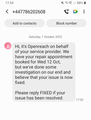

01-10-2022 06:03 PM - edited 02-10-2022 08:35 AM
@Chris-TalkTalk, Openreach has sent me this, but I am holding off replying to them until you have had time to monitor things from your end.
What would they have been doing to fix things....? I won't be using the home wifi much before Monday as it's a busy weekend, so am unable to assess properly till you get back anyway.
Maybe we should monitor it till about Wednesday 5th, which still leaves plenty of time to either keep the appointment or cancel?
