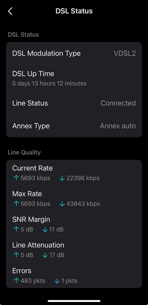

This I think my third time my bandwidth has dropped, now too 22 Mbps. I am tired of going to the helpdesk who are then follow a complete protocol checking my internal WiFi until they find out the problem is with the TalkTalk connection. Then in most cases nothing happens as I am diverted to yet another team and each time it takes me at least half a day.
Last time I raised this here and it was solved and my speeds was (shortlived) 33 Mbps (28 Mbps is the contracted value), 22 what I have now is on the edge if I work from home and my wife watches TV..
I attach the screenshot from the TalkTalk side showing it already one week below the contracted value and I hope they are able to solve this permanently so I don't have to complain every quarter.

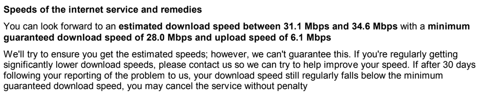

I understand you did what was expected, but my wife cannot stay at home for her work to wait for an engineer. And I like I stated before TalkTalk should have acted on their site when they noticed by bandwidth was dropping. Instead the threshold was lowered, without notifying me and I do have contract stating 28 Mbps.
Then proposing to send me an engineer with a possible £ 75,- cost is unfair tbh.
I must say this is I think the 3rd or even 4th time I issue the same complaint and this is the first time an engineer is proposed. Last time it was solved by the reset, and I accept the reasoning that the line needs investigating, but I cannot accept the £ 75. If TalkTalk does not act on that I simply switch provider. I am entitled to as the do breach the contract by not providing the contracted bandwidth for 2 weeks.

I agree, but I have a contract with TalkTalk they provide a speed of 28 Mbps and they have lowered the threshold to 22 Mbps so no engineering action was initiated . They wait until I start complaining and if I don’t (like 95% as
they have no clue on what the actual bandwidth is) they underperform their contract without penalty. The proof for not delivering the promised bandwidth is on their side. It’s not about £ 75, it’s a matter of principle.

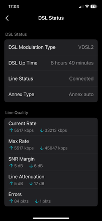

This is what I can see from my side:

This is what Karl did and the speed went up to 35 Mbps:  "I've reset DLM profile via Openreach, see if this helps."
Do that and it's done. No need for switching routers, sending engineers. Just reset the line and it will be good.

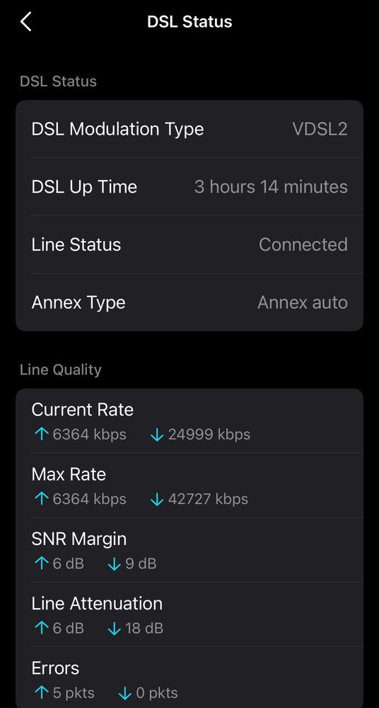

I reconnected my own router that gives me 21 Mbps, the TalkTalk router, even after reset did not connect.
