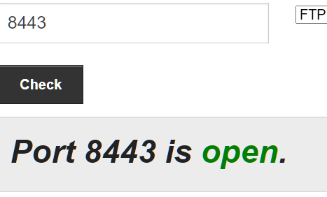

I have just set this up & it worked the first time:-
PF rulePF rule
Testing via a port checking website:-
Tested 8443 with port 443 open on PCTested 8443 with port 443 open on PC
I did not get the "Operation could not complete, something wrong happened." error at all. I am running later firmware that is under test, but I never saw this error ever in V158 either. What happens if you do a factory reset of the Hub 2's configuration, does that get rid of the error?
