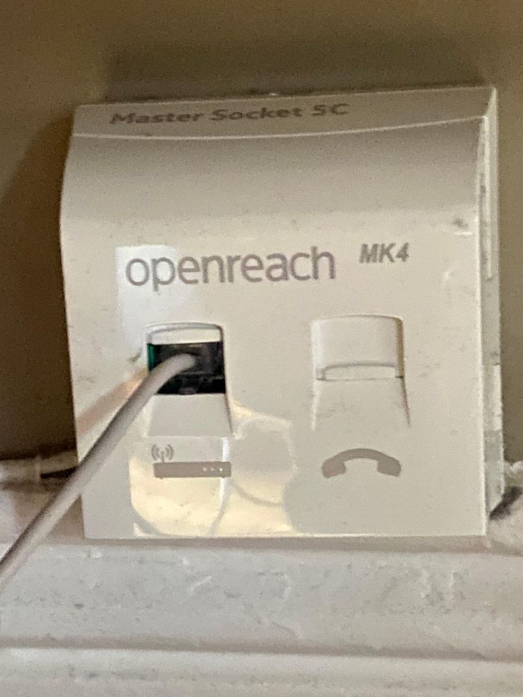

on 08-06-2023 09:51 AM
Message 15 of 20
Hi zzzzzzz
The bottom master socket in the photos should have a test socket underneath the face plate.

on 08-06-2023 09:45 AM
Message 16 of 20
We had issues a couple of years ago and the BT engineer changed our wiring the open box shows the first socket is not wired in which has the test point, this goes to a new master socket also shown in a second picture.
The Router is plugged directly into the new master socket, will this also have an internal test point.
We do not have a home phone so cannot check if the line sounds clear.
