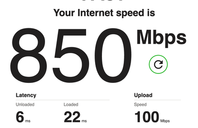

I have just done a wireless speedtest on my eero pro6, seems fine to me:
