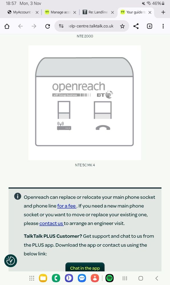

Yes it is city fibre. I have put it in the test socket & it is clear. What do I do now? Just put the face plate back on & plug it into the normal phone socket again??

OK, thanks for that. So what you seem to have is a City Fibre installation with what is known as a copper leave-behind service for your phone. On that basis you can safely remove the faceplate on the Openreach socket and connect the phone directly at the test socket. Try that and let us know whether that improves things, or not.

OK, do you have a router separately connected to a Fibre box on the wall, or does it connect to the broadband port on the phone socket?
Message 11 of 17
My router is separate to the phone,  it is not connected to the phone socket.  Where should my phone be connected to?
S R Marshall
Message 12 of 17
If you have Full Fibre then you wouldn't normally be using the phone socket. Is your router in fact connected to that socket also? If so, you can unclip the faceplate and connect the phone directly to the test socket behind. But this will interrupt your broadband connection, unless you use a plugin microfilter with a splitter at the test socket. Please clarify before we can advise further.

I can do this tomorrow.  I have this phone socket & no ADSL filter. I have full fibre broadband so it is separate.

Have you tried connecting at the test socket?
