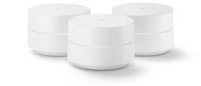

Google Wi-Fi
Google Wi-Fi is one of the highest profile Wi-Fi mesh systems to come on the market and has a reputation as a really easy to set up system with a great app.  It didn’t disappoint us!
Setting up Google Wi-Fi was no bother, with the app helping every step of the way, from using a QR code on the bottom of the node to identify it, to providing helpful hints on where to place the second node.
Once up and running, we could use some of the advanced features like priority device to give the Chromecast in the bedroom the highest priority.  We also liked the Family Wi-Fi feature which lets you pause the whole internet, or just one device, or switch the internet off during homework time.  Another great feature is that you can easily see how much bandwidth each device is using – brilliant for finding out who’s been downloading the most!  There’s even a built-in speed check to keep an eye on your broadband speed.
One downside of the Google Wi-Fi is that the advanced features only work in Router Mode which can cause compatibility problems with Double NAT.  You can switch Google Wi-Fi to use Access Point Mode, which they call Bridge Mode, although that disables the mesh so you can only use one node, which is a bit pointless if you need a mesh system for coverage.
What this means in practice is that unlike the TP-Link Deco, the Netgear Orbi and Linksys Velop, you don’t have the flexibility to change from the feature-rich Router Mode to the more basic but more compatible Access Point Mode if you need to.
Google Wi-Fi was also the only system that we couldn’t make work with the YouView box. On the plus side, it is the only system with built-in support for Philips Hue lights which you can easily control by typing on.here into any web browser.
Techy notes
Google Wi-Fi is a dual radio system with Bluetooth, and also has Zigbee built-in for home automation with accessories like Philips Hue lamps.
What we liked:
Excellent easy-to-use app with the ability to see your network activity when away from home and some useful advanced features like priority device and scheduled internet time.
What we didn’t like:
Doesn’t work with TalkTalk TV.  Access Point Mode works only with one node, so not a mesh system.  Limited control for advanced users, like no ability to choose the Wi-Fi channel.

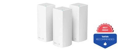

Linksys Velop takes Wi-Fi mesh performance to the next level, but with a price point to match.  Unlike BT Whole Home Wi-Fi, TP-Link Deco and Google Wi-Fi, Velop has three radios including one which is dedicated to providing a link, sometimes called backhaul, between all the nodes.
You may ask – what does that mean and why is it important?  In Wi-Fi mesh systems with dual radios, one radio works on the Wi-Fi 2.4GHz band and the other works on the Wi-Fi 5GHz band.  The 2.4GHz radio is used to connect to your wireless devices, and the 5GHz band is also used to connect to wireless devices but also provides the link between the mesh nodes.  For brilliant Wi-Fi coverage, this works well but the whole system can slow down a bit if you have quite a few devices using the faster 5GHz band because the band has to be shared between providing Wi-Fi to devices and providing the link between the nodes.
The most advanced mesh systems, like the Linksys Velop and the Netgear Orbi, have a special dedicated 5GHz radio to connect the nodes, leaving the other 5GHz radio to connect your devices at maximum speed.
So it looks like it should perform amazingly well, but do you need a degree in engineering to set it up?  Thankfully, Velop has a really easy-to-use app for setting up and managing the system.
We tested the three node Velop system, which is the priciest system here at £499.99 although it has been on sale for £292.99 making it a more affordable option for anyone who needs a high-performance system.  There’s also a two node Velop system which may be suitable for many homes.
Velop nodes are great looking – like mini towers – and the two LAN ports and power socket and on/off button are hidden out of view on the base of the unit, with a small slot on the side near the bottom for the LAN and power cables to come through – a design touch we really liked.
Setting up Velop was a piece of cake, with the app guiding us through the process of setting up the first node and then making sure the second and third nodes had a good connection to the first node.  Like the TP-Link Deco and the Google Wi-Fi, you have to set up an online account, which is then used to manage the network when you’re away from home.
Velop worked well with the TalkTalk YouView box in both Router Mode and Access Point Mode, and the dedicated 5GHz backhaul helped keep a solid connection.
Techy notes
Triple radio with dedicated 5GHz channel for backhaul.
What we liked:
Very good performance for users with lots of devices, thanks to triple radio design with dedicated 5GHz link.  Best app with a good range of advanced features including priority wireless for up to three devices.
Most expensive system, although for most homes only two nodes will be needed.

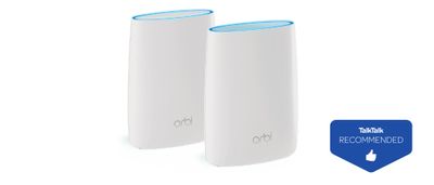

Netgear Orbi
Netgear Orbi comes in three different versions, each one at a different price point and with a different radio configuration, and like the Linksys Velop they all have three radios including a dedicated 5GHz backhaul link.  The three Orbi systems are called the RBK50, the RBK40 and the RBK30, each consisting of a base router and a satellite node.  You can buy add-on satellites to grow the system, and there are three satellite types – the RBS50, the RBS40 and RBS30. Confused?  I was. Thankfully all the satellite types work with all three Orbi systems, although you can’t help wondering if Netgear could have made things simpler by making a single node type like the other four systems we tested.
Setting up the Orbi RBK50 took longer than the other four mesh systems and although the set-up started well on the app, I ended up having to use a web browser on a laptop to finish the setup which included updating the firmware on the base router and the satellite node.  I also made a mistake plugging the LAN cable from the Orbi router to the TalkTalk Super Router, using the wrong port on the back of the Orbi, so if you end up setting up an Orbi system make sure you look carefully for the LAN socket which is dedicated for connecting to the broadband router!
Compared with the Velop app, the Orbi app has fewer features.  To access advanced features like port forwarding, dynamic DNS, VPN Service, Static Routes and VLAN/Bridge settings you have to use a web browser and log in at orbilogin.com
Like the TP-Link Deco and the Linksys Velop, the Netgear Orbi supports Router Mode and Access Point Mode, although we could only connect the YouView box when the Orbi was in Access Point Mode.
Parental controls are through separate apps – either Netgear Genie or just announced is Circle with Disney which has a free basic subscription and a premium paid-for subscription at $4.99 per month.  We would have preferred easy-to-use parental controls built in to the main Orbi app.
Overall we found Orbi to be a more frustrating system than it could have been with a better app.  In our testing, the Orbi performed amazingly well with just two nodes, where other systems like the TP-Link Deco needed three nodes.
Techy notes
Most advanced radio system – triple radio with 2x2 for 2.4GHz and 5GHz access channels, and 4x4 for the fastest dedicated backhaul channel.
What we liked:
Fastest performance of all five systems.  Looks good.  Suitable for advanced users who are happy to configure with the web interface.  For most homes, two nodes will give as much coverage as other three node systems.
Poor app compared with others.  Doesn’t support priority devices.  Parental controls require a separate app.
