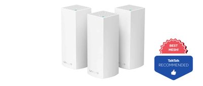

Linksys Velop takes Wi-Fi mesh performance to the next level, but with a price point to match.  Unlike BT Whole Home Wi-Fi, TP-Link Deco and Google Wi-Fi, Velop has three radios including one which is dedicated to providing a link, sometimes called backhaul, between all the nodes.
You may ask – what does that mean and why is it important?  In Wi-Fi mesh systems with dual radios, one radio works on the Wi-Fi 2.4GHz band and the other works on the Wi-Fi 5GHz band.  The 2.4GHz radio is used to connect to your wireless devices, and the 5GHz band is also used to connect to wireless devices but also provides the link between the mesh nodes.  For brilliant Wi-Fi coverage, this works well but the whole system can slow down a bit if you have quite a few devices using the faster 5GHz band because the band has to be shared between providing Wi-Fi to devices and providing the link between the nodes.
The most advanced mesh systems, like the Linksys Velop and the Netgear Orbi, have a special dedicated 5GHz radio to connect the nodes, leaving the other 5GHz radio to connect your devices at maximum speed.
So it looks like it should perform amazingly well, but do you need a degree in engineering to set it up?  Thankfully, Velop has a really easy-to-use app for setting up and managing the system.
We tested the three node Velop system, which is the priciest system here at £499.99 although it has been on sale for £292.99 making it a more affordable option for anyone who needs a high-performance system.  There’s also a two node Velop system which may be suitable for many homes.
Velop nodes are great looking – like mini towers – and the two LAN ports and power socket and on/off button are hidden out of view on the base of the unit, with a small slot on the side near the bottom for the LAN and power cables to come through – a design touch we really liked.
Setting up Velop was a piece of cake, with the app guiding us through the process of setting up the first node and then making sure the second and third nodes had a good connection to the first node.  Like the TP-Link Deco and the Google Wi-Fi, you have to set up an online account, which is then used to manage the network when you’re away from home.
Velop worked well with the TalkTalk YouView box in both Router Mode and Access Point Mode, and the dedicated 5GHz backhaul helped keep a solid connection.
Techy notes
Triple radio with dedicated 5GHz channel for backhaul.
What we liked:
Very good performance for users with lots of devices, thanks to triple radio design with dedicated 5GHz link.  Best app with a good range of advanced features including priority wireless for up to three devices.
What we didn’t like:
Most expensive system, although for most homes only two nodes will be needed.

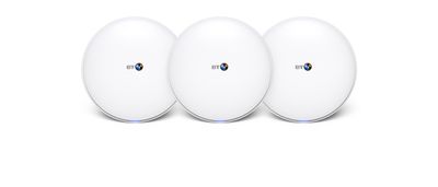

We wouldn’t normally recommend BT products but from the big discounts available now, they’re quite good value and work well although they have the fewest features.
BT Whole Home Wi-Fi is available in two disc and three disc versions for £149 and £189. Each disc is about the size of a side plate and sits on a chunky metal stand that you can’t move or remove.  Setting up is quite straightforward – the first disc connects with a LAN cable to the router and an LED on the bottom shows the connection status – purple when turning on, blue for a good connection, red for no connection and orange means you have a connection but you should move the disc closer to one of the other discs.
Like all Wi-Fi mesh systems, the BT Whole Home Wi-Fi creates a new Wi-Fi network that’s separate from the one created by your router.  If you stick with the default Wi-Fi name and password for the BT Whole Home Wi-Fi, you’ll find convenient pull-out cards on the back of each disc as a helpful reminder, although you can change the network name and password if you want.
Each BT Whole Home Wi-Fi disc has one LAN port and you can use this to connect to a YouView box although we recommend powerline adapters for the most reliable connection.  Out of the box, the BT Whole Home Wi-Fi is configured in Access Point Mode [see below] and the only extra feature is the ability to pause the entire Wi-Fi network which isn’t as useful as the individual device control of other Wi-Fi mesh systems we looked at.
Techy notes
BT Whole Home Wi-Fi is a dual radio system with an advanced 4x4 antennae configuration, giving it an AC2600 classification.  1 x LAN port per disc.
What we liked:
Easy to set up. Low cost. Good performance.
Fewest features – only the ability to pause all Wi-Fi connected devices.

Which brings us to the overall winner in our five-way test – the Linksys Velop.  We loved the smart design of the mini tower nodes with the hidden ports underneath, we found the set-up as simple as ABC and we enjoyed using all the advanced features – easy guest Wi-Fi, parental controls, priority device, access when away from home, built-in firewall and a cool feature to scan for free Wi-Fi channels.  And like the TP-Link Deco, the Velop comes with a reassuring three-year guarantee.
