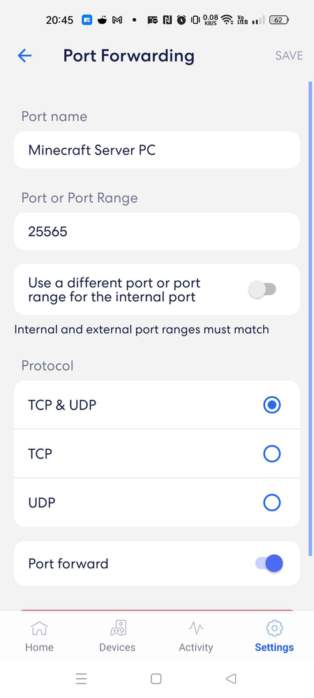

I have setup a Port-Forwarding rule in my Eero app that should allow for my friends to connect to a Minecraft server I have setup on a separate PC however whilst I could connect to the PC fine (through the Port-Forwarded IP and IP Port) my friends couldnt connect?

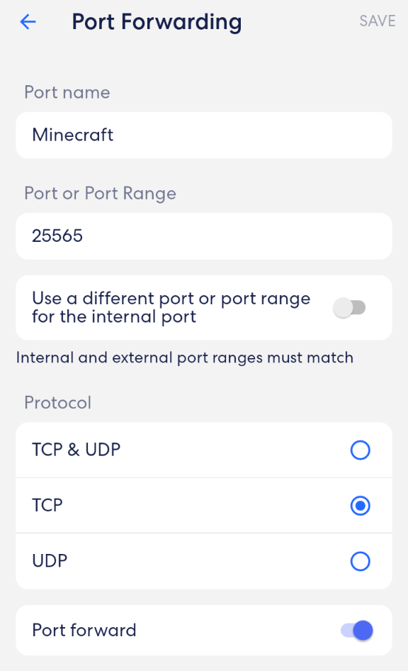

Of course TalkTalk allow port forwarding. I have been doing this for years & never had any issues.
I have just tried this & proved that it worked first time. When running Minecraft on a PC all you need is to forward is TCP port 25565.
TCP 25565

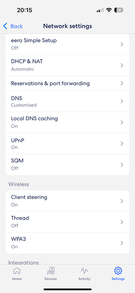

I have no idea on the DHCP/NAT issue, but I have habitually avoided TalkTalk DNS servers for years. No idea if that will make a difference in your case.

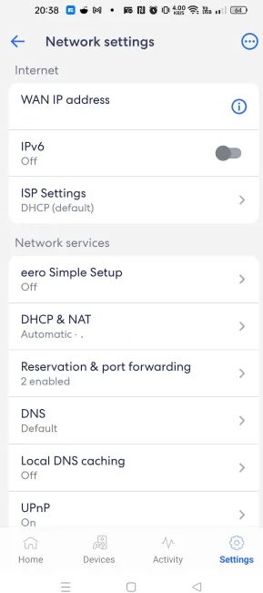

Upon checking DNS settings (unmodified - still on Default DNS - I noticed yours was Customised) I did notice it had a set primary and secondary IPV4 IP on the default setting?
Also does the DHCP & NAT IP need to be the same as the server PC IP to port forward it?

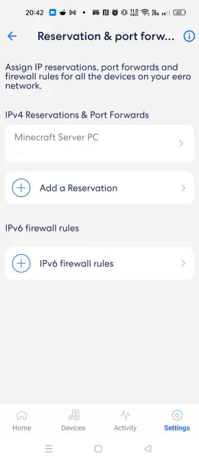

I attempted doing this through the Eero App using my PCs IPV4 address as the Static port (I didnt touch anything except adding the IP address as my PCs IPV4 address and changing the port to 25565 (the default port Minecraft uses) using TCP & UDP
It didnt work with this setup.
I tried using YouGetSignal to see if itd detect any open ports on that PC, using the default gateway (I checked through ipconfig in Command Prompt) or its IPV4 address and it said all of the ports were closed (it was still connected to my router via Ethernet)
