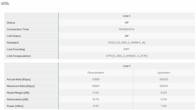

I have an ADSL2+ connection which, when working used to be 30Mb+, but started to suffer from a lot of dropouts. The online diagnosis claims "there's nothing wrong" even though I can see the cap in the router (max D/L speed) and this is less than the "guaranteed" speed.

At no point would anyone listen to me telling them that I can see the "max speed cap" in the router and it's their system masking an external fault which OpenReach have not fixed at all.

The "Actual Rate" never changes from 11399 implying it's system set from the ISP side of the connection.
When it was 30+ (a fluctuating number from 25Mb to 35Mb) it was fine for almost 2 years, but then started to suffer from droputs. My "guaranteed" is rate is 30+.

Please can you include a screenshot of the line statistics that you are referring to, so that I can check them & process this accordingly?
