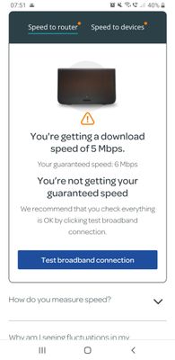

Yesterday my internet dropped c 1pm, but came back up after a few minutes.
Today it went down earlier, during the morning, and was long enough for me to bother to run a test to check it. Though the connection was back, it was below the minimum guaranteed speed:

Another disconnection just now, so it seems to be happening a few times per hour...
And another 😪😪:
 Not useable in this state, and it does waste so much time! Off to actually get my breakfast....!

@Anonymous, I switched off the router overnight and have now swapped it for my old HG635.
Despite all the disconnections I've had over nearly a fortnight using the Sagemcom, the download speed has gone straight up to c 12Mbps, which is not bad going, considering that speeds were so bad with the Sagemcom. Odd that I had the improvements for a day or so when @Debbie-TalkTalk intervened.

Now Service Centre is totally all over the place:
I have tried running the speed test 3 times now through Service Centre and just got that result. However its initial general report is saying 13Mbps to the router.

C. 24 hours still below the minimum guaranteed speed,  @Debbie-TalkTalk.

Also, checking speeds, downloading is again below the minimum guaranteed:
Let me know if you think it is time for me to try with the HG635, if there's nothing more you can do with the firmware.
It is looking rather all over the place:
