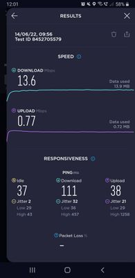

Yesterday my internet dropped c 1pm, but came back up after a few minutes.
Today it went down earlier, during the morning, and was long enough for me to bother to run a test to check it. Though the connection was back, it was below the minimum guaranteed speed:

Ping and jitter were relatively OK yesterday, with this speed:
Began to increase here, when he finished the first time.
A bit worse here, after he came back and we moved the router downstairs. Notice only a fractional difference in speed however:
Dreadful jitter here after the disconnection:
I don't know if I am reading these results correctly. Unnerved by that disconnection .....
